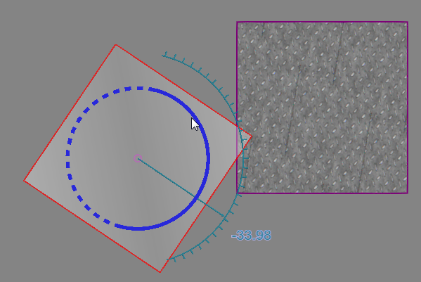

- To move the projection on the selected object, either use the Move tool in the 3D world or edit the location in the Texture Mapping task pane. In either case, you are moving the projection not the object.

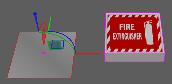

Example. Mapping texture to surface with one UV tile

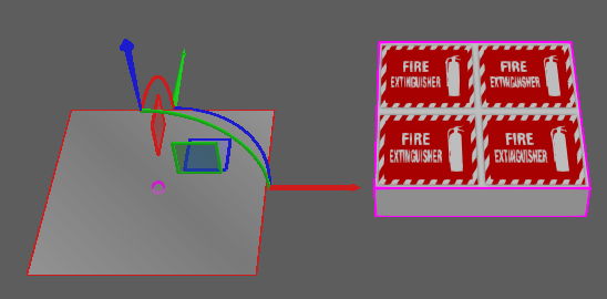

Example. Mapping texture to surface with multiple UV tiles
Example. Mapping texture to surface with smaller UV space and multiple UV tiles

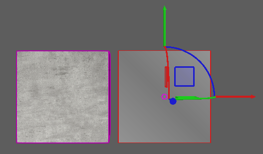

Example. Mapping texture with bumps to surface
